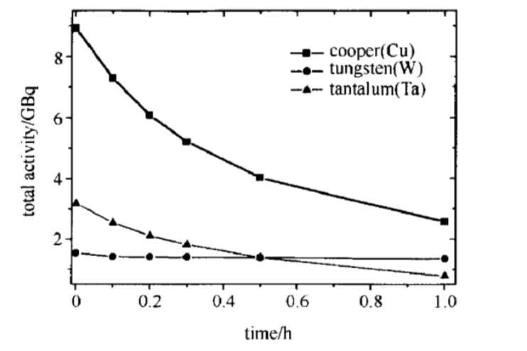

I use resnucle card to calculate the activity of 20MeV,50μA proton bombardment tungsten target 10 min,the total activity in tungsten is higher than the literature results ,could you please help me find my mistakes?
the result of literature as shown in the figure below,it should be about1.6GBq,I calculated the results for 0 hours

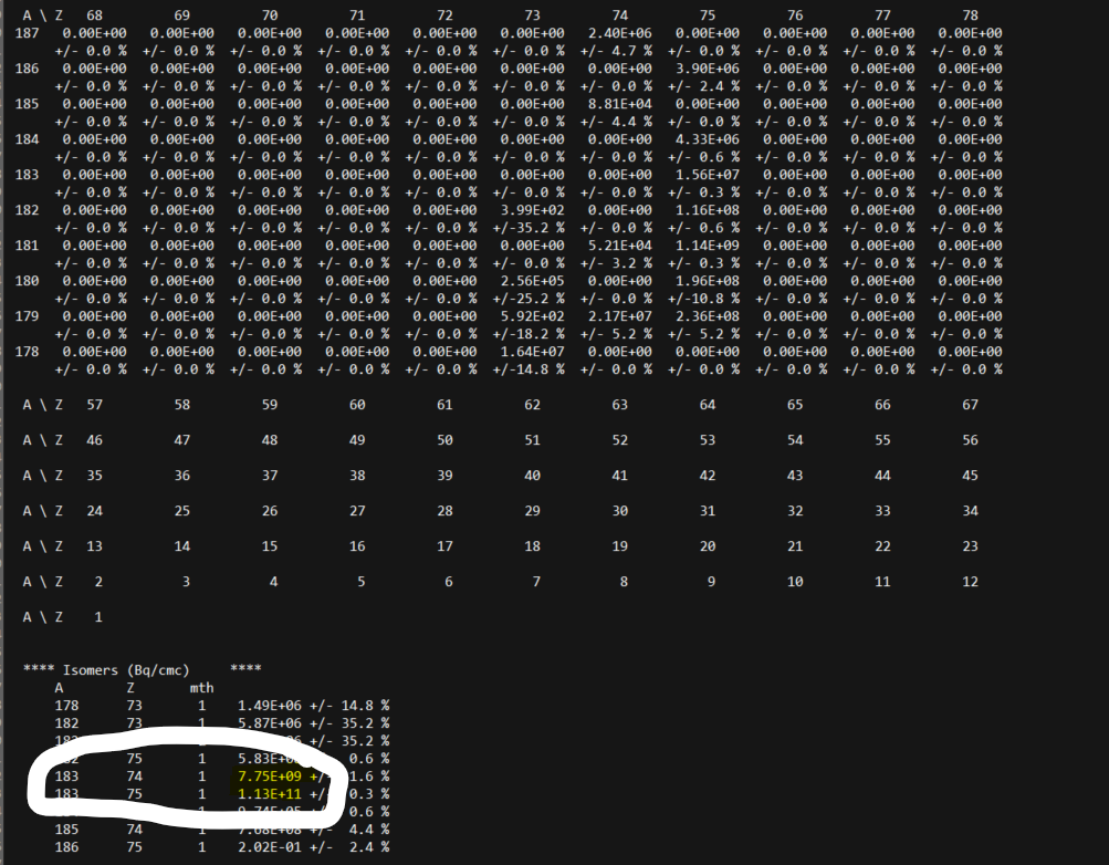

In the end,about the output lis file,should the activity of isomers be considered? I found that the activity of isomers is much greater than that of other nuclides。

I cannot judge on your specific problem and the comparison to literature that you are trying to do. But I can only suggest that you make sure that the parameters on which your literature data is based is modeled as closely as possible. So if they consider meta stable states in their total activity then you should also do this. If they do not, which sometimes is the case, then you should not. In the .lis file of FLUKA they are taken into account.
You should also make sure that you are comparing the same cooling time. In your case with t=0 you will of course also see very high numbers for short lived isotopes like Re-183m which has a half-live in the range of ms.
Generally, make sure that you know those parameters (irradiation, cooling, geometry, etc.) of your literature data well because otherwise you might not be able to make meaningful comparisons.

Thank you for your advice,I’ve tried to use activate also COALESCENCE in an additional physics card,but the difference between the results is very small。From the literature, the cooling time is 0,maybe I should check with the author of this paper。
