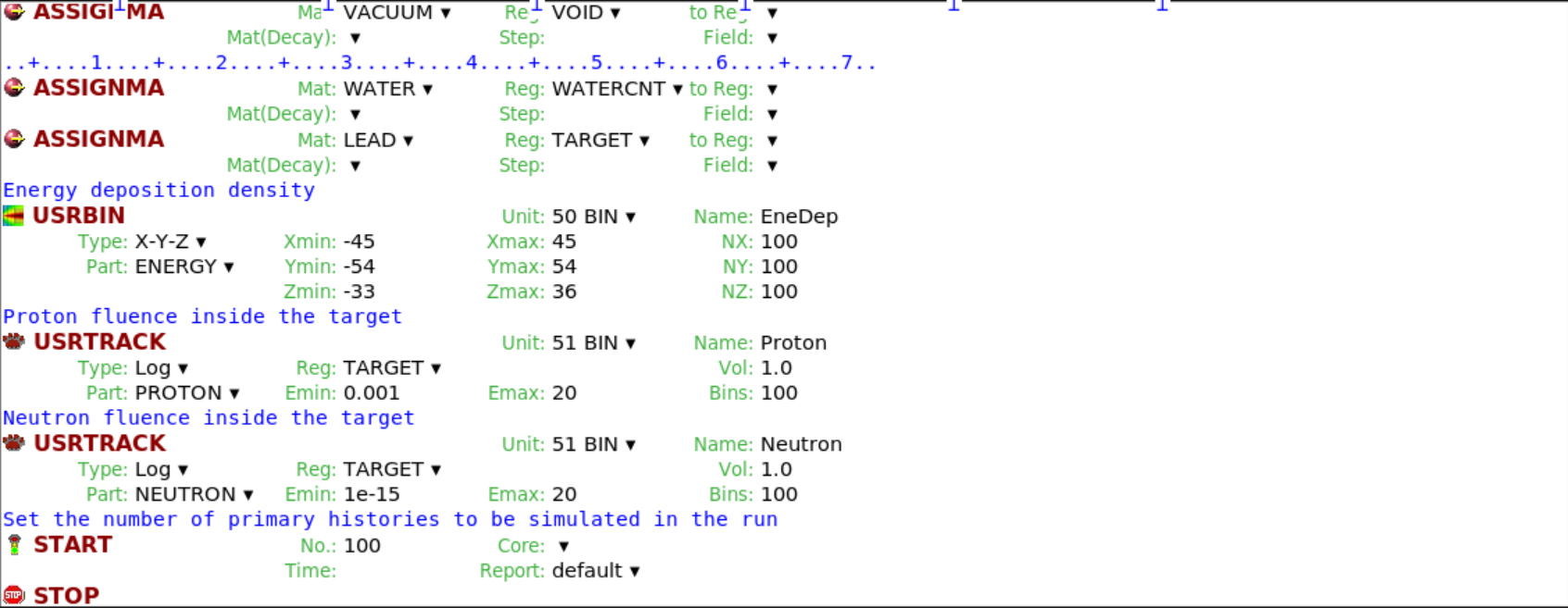

I am fighting since days to identify what is not working in this example offered on the Fluka site.
I made 3 screen shots to cover the full program that I wrote in Flair.
I am near to give up. I do not see any difference with the example given
if someone can have a look, the help would be more than welcome.

I corrected the file accordingly. The errors found in geometry have now desappeared.
Then I went to the RUN tab, and clicked on Start button.
After a 3 seconds, I got on the Status : Finished with errors (in red).
if it is OK for you, why is it not so for me ?
