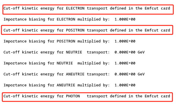

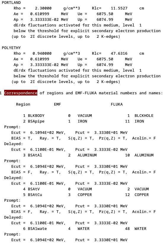

Kindly guide me what is happening? Why is the transport threshold energy for electrons and photons in the out file so high, reaching tens of MeV? I attempted to reduce the transport threshold using the EMFCUT card, but it seems to have little effect. Could there be a mistake in the settings?
EMFCUT
Forget about LOW-BIAS that applies to the old groupwise low-energy neutron treatment.
Also, default PRECISIO thresholds for EM particles, namely 33 keV for photons, may not require further adjustment by EMFCUT.
The problem comes from the (pointless) use of RADDECAY, where - through the fifth input field - you raise the EM thresholds so as to disable the prompt EM transport.
I guess that your shielding study concerns prompt dose, during proton irradiation. RADDECAY and associated cards (IRRPROFI, DCYTIMES and DCYSCORE) are meant for decay radiation (that does not include neutrons, by the way), due to delayed radioisotope decay in the absence of irradiation, and should then be removed.
I need to study both the prompt radiation during proton irradiation and the induced radioactivity of the facility. Is it not possible to obtain prompt radiation and the decay of induced radioactive isotopes from the same case?
Of course it is, but for this purpose you should not kill the prompt EM radiation in the RADDECAY card, avoiding to rescale there the respective transport thresholds (leave WHAT(5) empty).
