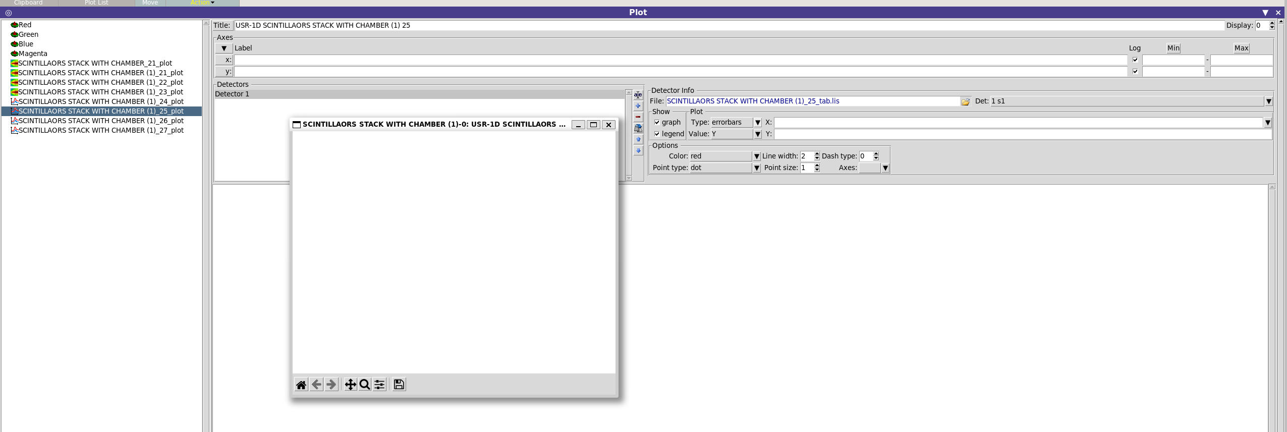

Dear Expert,

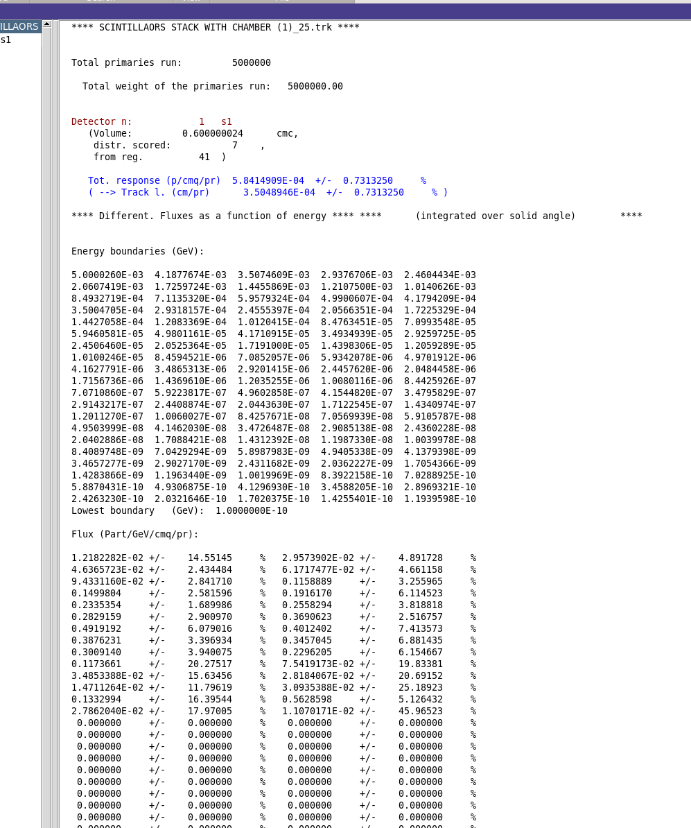

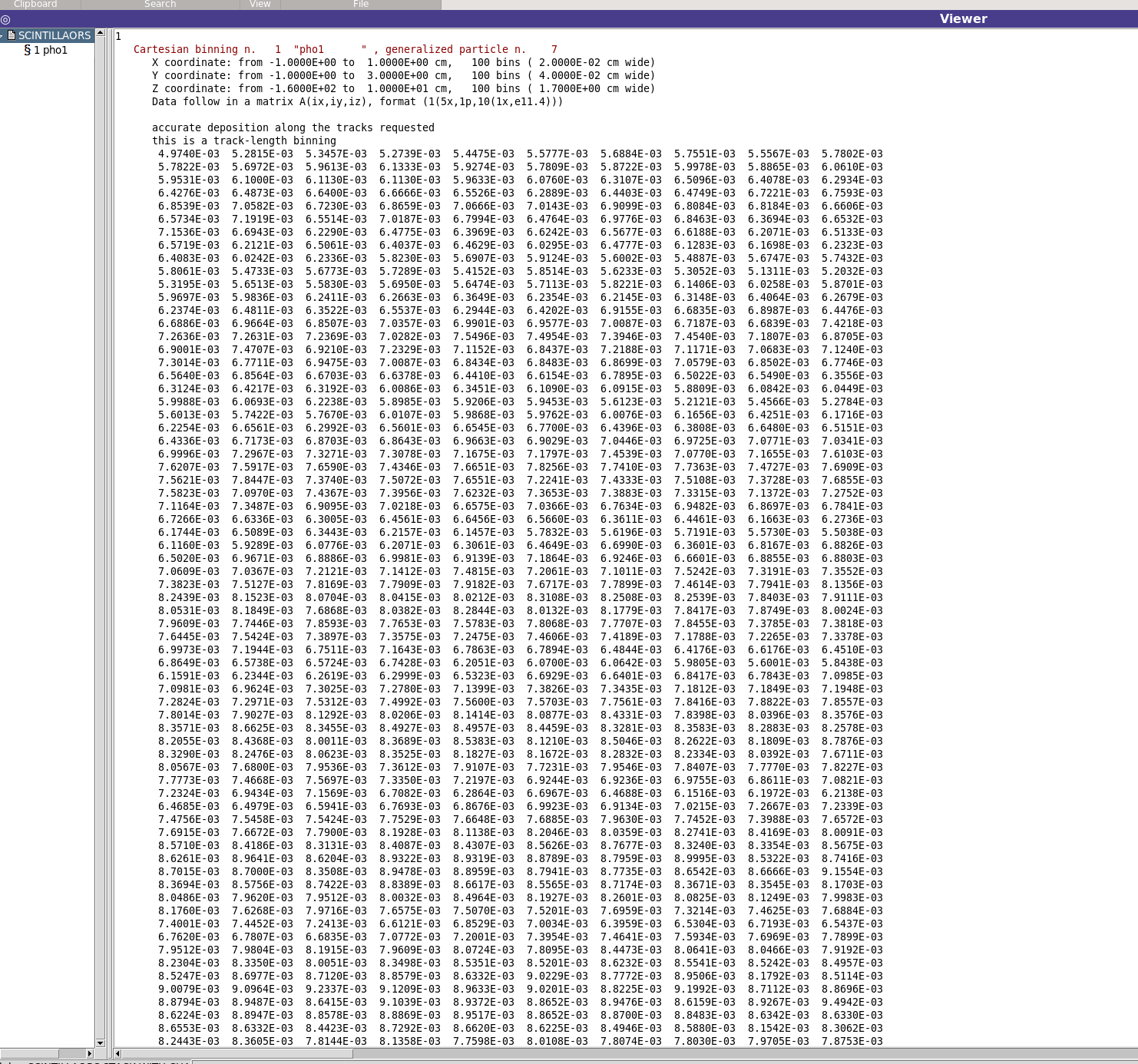

I’m encountering an issue with Flair—it’s not generating any plots and only displays a blank tab when I attempt to plot something. I’ve checked the output files, and they do contain data.
I’m attaching screenshots for your reference. Thank you

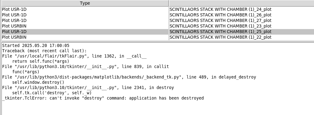

Thanks for the reply, I am getting following output.
Started 2025.05.20 17:00:05
Traceback (most recent call last):
File “/usr/local/flair/tkFlair.py”, line 1362, in call
return self.func(*args)
File “/usr/lib/python3.10/tkinter/init.py”, line 839, in callit
func(*args)
File “/usr/lib/python3/dist-packages/matplotlib/backends/_backend_tk.py”, line 489, in delayed_destroy
self.window.destroy()
File “/usr/lib/python3.10/tkinter/init.py”, line 2341, in destroy
self.tk.call(‘destroy’, self._w)
_tkinter.TclError: can’t invoke “destroy” command: application has been destroyed
Regards
Shubham
Hi @talktoshubhama I would guess that the problem is that you have parenthesis in the filename of the datafiles “(1)”.
The python traceback you see is something else, when you close a window from the button and python takes some time to react while the window is already closed.

Sorry for the late reply. I tried renaming the file to remove “(1)”, but I’m still not seeing the plot. The plot window opens, but it’s completely empty — not even the axes are displayed. I am using this on windows with ubuntu terminal
