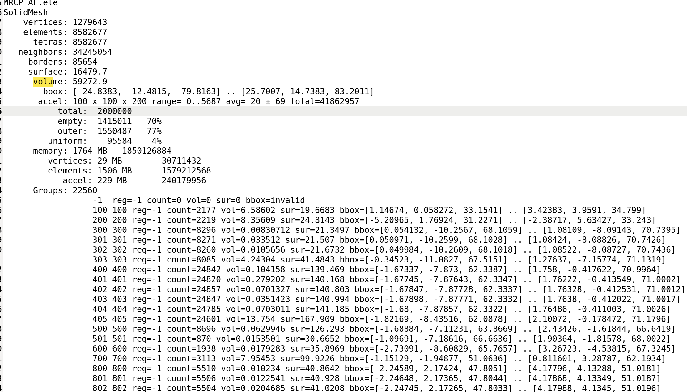

The simplest way to obtain the volume information is to inspect the output file of the simulation. For each organID you will have the corresponding volume in cm3. For example:
