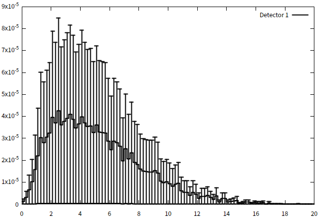

The second issue is that the error in the energy spectrum is particularly large, and even with a large number of particles, this error does not decrease, which contradicts the typical behavior of a Monte Carlo program.

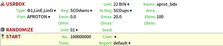

This is the example program I ran. I didn’t modify any code. Could you please take a look?

Regarding the error not decreasing, please increase the number of cycles to 2 or more.
Thank you for your response. The program is now running correctly. I will proceed to increase the number of cycles as you suggested. Thank you again for your reply.:handshake:
