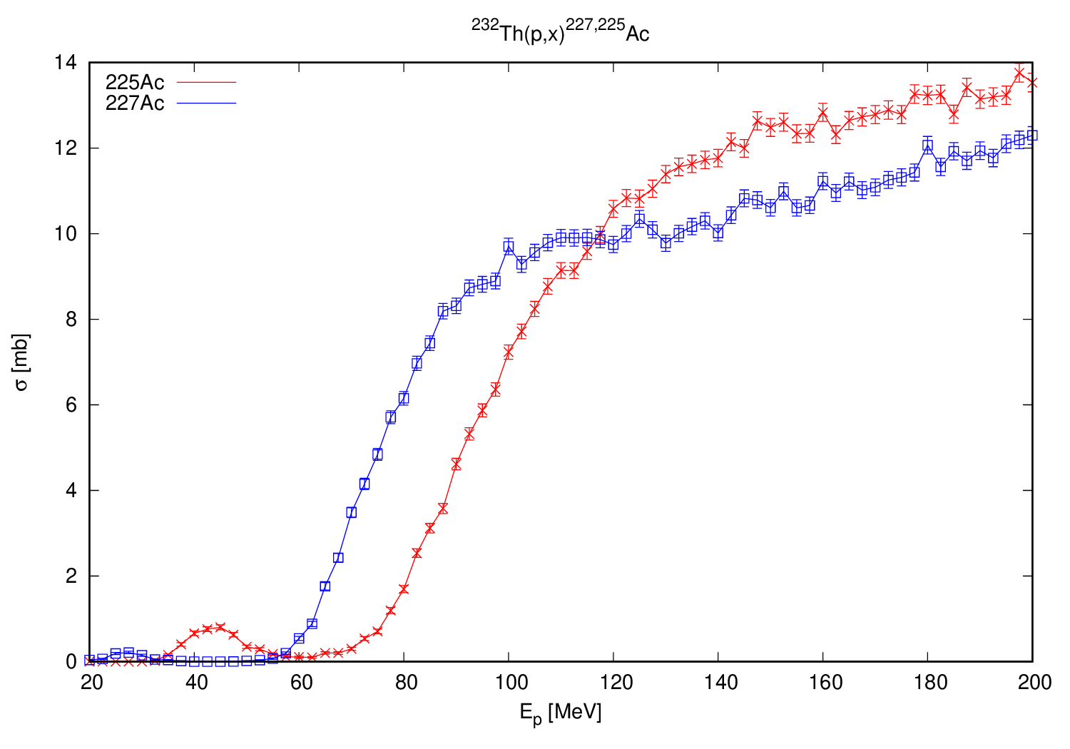

Recently, while organizing my simulation results, I observed a decline in the outcomes at 150 MeV. I believe such a drop should not occur under normal circumstances.
To investigate this, I reviewed other FLUKA simulations (http://dx.doi.org/10.1103/PhysRevC.102.044613), which confirmed that no decline should appear at 150 MeV.

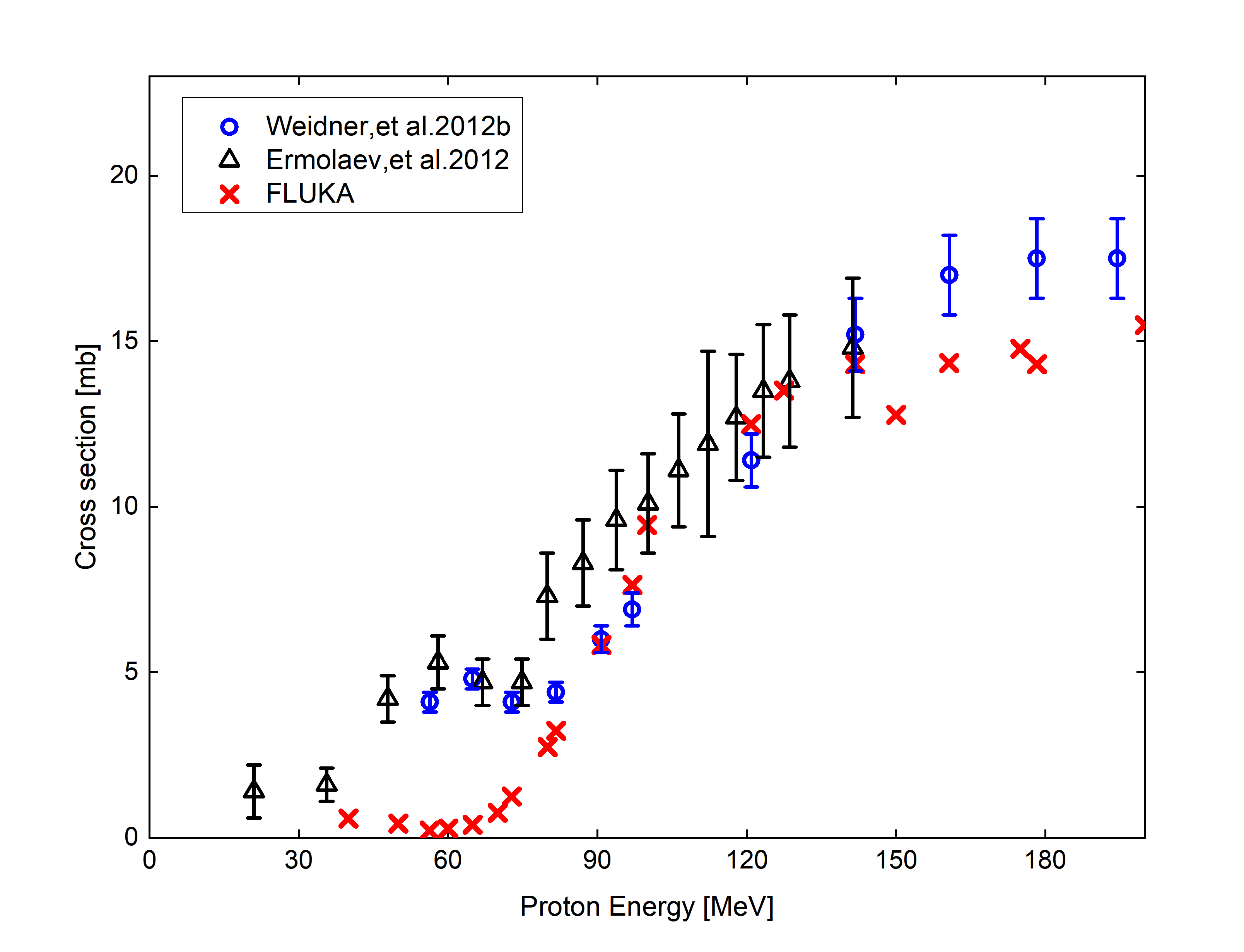

Additionally, I referenced results from forum experts (https://fluka-forum.web.cern.ch/t/ac225-and-ac227-cross-sections-for-proton-beam-on-th232-target/5059/4), which also showed no drop at 150 MeV.
Therefore, I concluded that there is an issue in my simulation.When I was searching for similar issues on the forum, I came across this post discussing model transition. How to use the RQMD model below 150 MeV/n?:

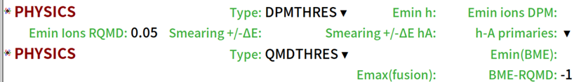

I would like to use the RQMD model entirely to compare the differences with the BME model. I added PHYSICS cards( SDUM=
DPMTHRESandBME-RQMD) according to the manual, but it doesn’t seem to work. Here are my input card and file.
