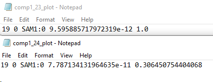

  2. Computer 1 → no 23: 9.595885717972319e-12 (1.0), no 24: 7.787134131964635e-11 (0.306450754404068)

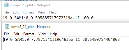

  3. Computer 2 → no 23: 9.595885717972319e-12 (100), no 24: 7.787134131964635e-11 (30.6450754404068)

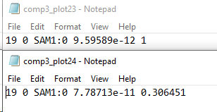

  4. Computer 3 → no 23: 9.59589e-12 (1), no 24: 7.78713e-11 (0.306451)

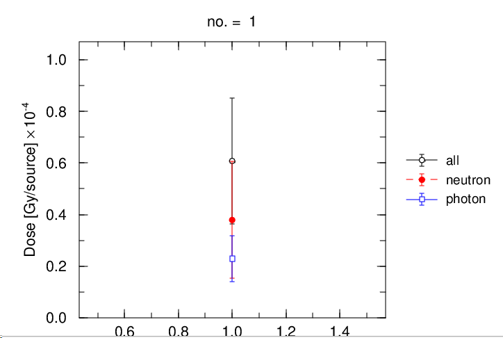

  5. I ran the corresponding program on PHITS using the same settings (I know PHITS better than FLUKA), and the dose uncertainty is indeed high (>40%).
Looking at the numbers, I already know this is the problem with treating decimals and percentages. But what’s interesting is that it manifests itself in how Flair generates the plot on each computer.

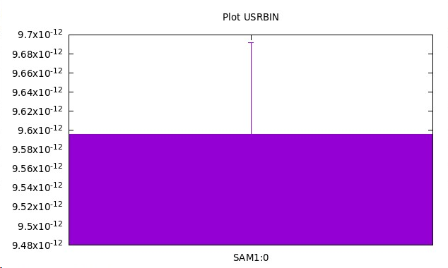

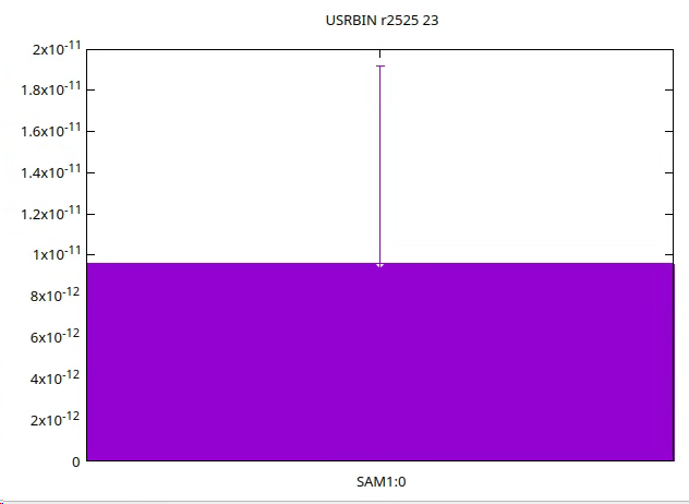

From above: plot from computer 1 & 3, computer 2, and PHITS (including the multiplier, but notice the error bar)
Flair interprets the uncertainty as a percentage while in reality the uncertainty is still very high!

Thanks for reporting this! I had a look at the merged binary file handling in Flair to create the .dat (it is in Flair’s Plot.py), and there was a bug in the way statistical errors are handled in the case of per-region USRBIN scoring. Errors were wrongly not multiplied by 100, while eventually the results in .dat should be in %. Further down the line, the plot creation process relies on the error to be expressed in % in the .dat (as you can see in output tab with the value*error/100).
Hence errors were 100 smaller than they should, in that specific case. This was fixed from Flair 3.4-5.3 onward. This explains why you were not seeing any discrepancy for USRBDX, and why for the per-region USRBIN, you were getting errors (e.g. for det 23) at 1 “%” with computer 1&3 (first plot), while the correct value is actually 100% (second plot), in consistence with PHITS error estimate (third plot).
