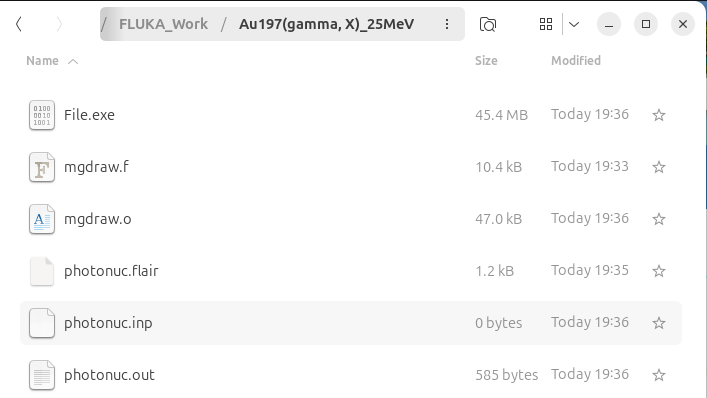

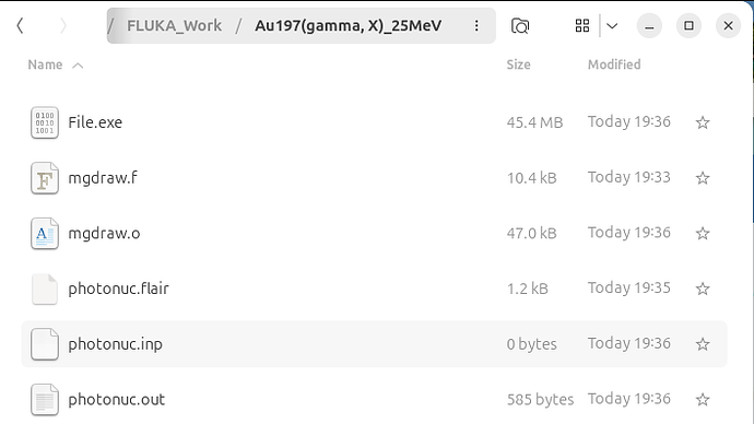

It’s just impossible. I’ve done anything as you said. Still the same. Here is .out file and the folder content.
photonuc.out (585 Bytes)
Now I see the problem. As a general recommendation, don’t use empty spaces (and parentheses) in the directory name!
It’s something new. I always used theme before.
I guess that what is new is the empty space at the end of your directory name.
