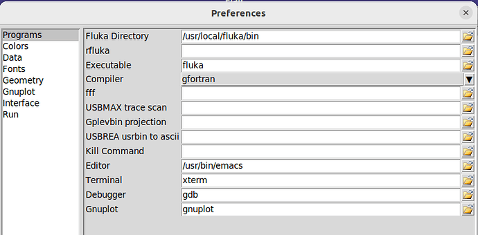

When I try to compile mgdraw.f file there are shown error that “[Error 2] no such file or directory /usr/local/fluka/bin/flutil/lfluka”. Here is preferences od FLAIR.

Dear Sergey,
the flair version you are trying to use in not supported on this forum. Please use the one available from https://flair.cern/
