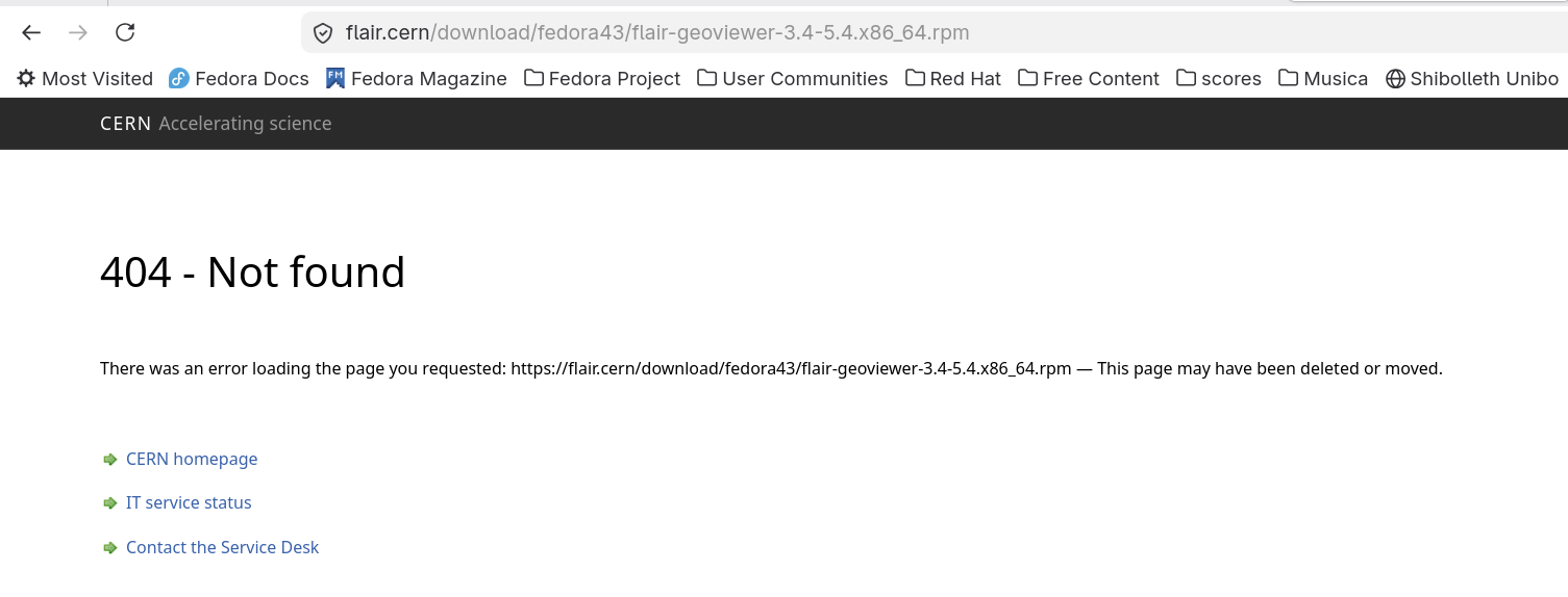

I confirm that on FC43, with tcl-9.0.2-1.fc43.x86_64 and Python 3.14.5, the last Flair packages (https://flair.cern/download/flair-3.4-5.4.noarch.rpm and https://flair.cern/download/fedora43/flair-geoviewer-3.4-5.4.x86_64.rpm) perfectly work.
Dear Mario,
I just checked the installation using the provided flair.repo, and I confirm that the incorrect flair-geoviewer package is installed.
Please remove the /etc/yum.repos.d/flair.repo file, uninstall the currently installed flair and flair-geoviewer packages, and reinstall them using the latest .rpm files.
