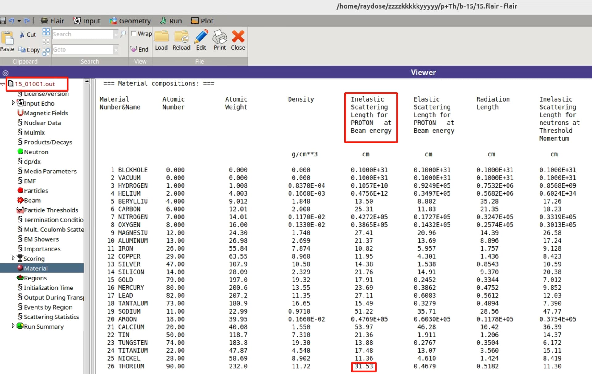

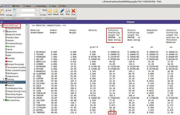

x << λused to define a thin target? I’d like to know what order of magnitude this implies. - As referenced in literature OVERVIEW OF SECONDARY NEUTRON PRODUCTION RELEVANT TO SHIELDING IN SPACE: " Thin targets (thin enough to limit the energy loss in the target to 5% or less) are used for cross section measurements." LISE++ calculations confirm that a 30~MeV proton beam loses 1.176~MeV (3.92% of incident energy) when traversing a 0.0125~cm thorium target, satisfying the thin-target criterion. For proton energies above 30 MeV incident on a 0.0125 cm thorium target, the thin-target criterion defined in the literature is satisfied.However, when I examine the lambda values printed in the output file (“Inelastic Scattering Length for PROTON at Beam energy”), I find that lambda increases as the incident proton energy decreases. This would imply that lower incident proton energies better satisfy the x << λ condition. This contradicts the conclusion I obtained from LISE++ calculations (where energy loss decreases at higher energies). I believe there must be an error in my understanding and would appreciate correct guidance.

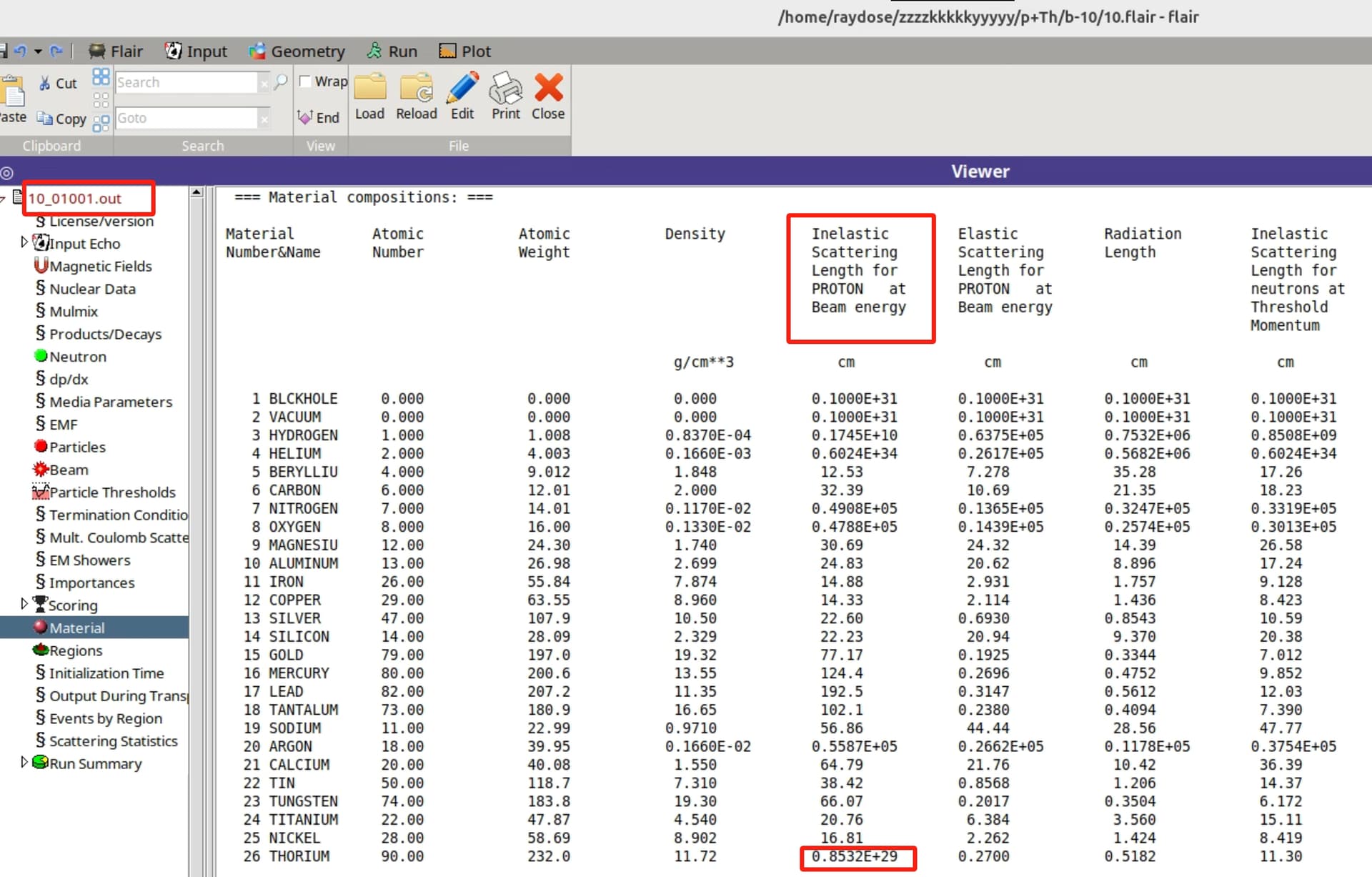

- Additionally, upon inspecting the output file, I observed that the “Inelastic Scattering Length for PROTON at Beam energy” values are normal (tens of cm) for energies above 15 MeV . However, at 10 MeV , it shows an extremely peculiar value: 0.8532E+29 cm. I would like to understand the reason for this. Is it because, at 10 MeV, the incident proton energy is completely deposited within the thorium target, rendering the calculation of cross sections meaningless at this energy? Can the 0.0125 cm thorium target be considered a thin target in FLUKA for 15 MeV proton incidence?
