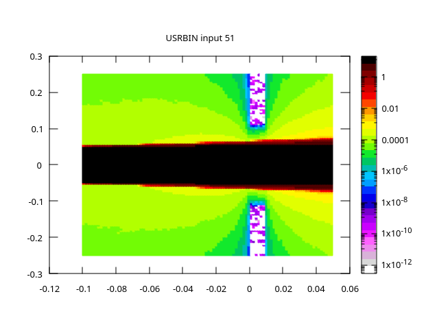

Dear @dprelipc,
The thickness of the calcium we have now defined is 100 micron (earlier it was 2.5 mm). However, the alpha particles seem to be penetrating through the target without fully stopping. In this case, we are not getting any output for RESNUCLEi (as shown in the attached image), which makes it appear that there is little or no interaction with the target. How should I correctly read and interpret the outputs in the sum.lis and tab.lis files for RESNUCLEi? My aim is to study the production of radioisotopes from the ^{40}\mathrm{Ca}(\alpha,p)^{43}\mathrm{Sc} reaction and calculate its yield. Could you suggest the correct workflow to obtain this? Thank you.
input.inp (4.7 KB)
input_80_sum.lis (1.1 KB)
input_80_tab.lis (2.4 KB)
Dear @anupam,
  1. The reason why your file is empty is because of your additional AUXSCORE card. Remove it, and you will have the output as before.
  2. If you want to bias/artificially increase the yield, you can use a LAM-BIAS card, as you are now using in your input file in your second answer.
  3. To interpret the results of the [RESNUCLEi card](file:///usr/local/fluka/doc/html/chapters/description_input/description_options/resnucle.html), please have a look at note 10. There is a python script fluresnucle_formatter.py which can help you.
That being said, you are already using the correct workflow to obtain what you want, and the current output already confirms this (see below). Again, my question to you is: why do you expect to see a higher yield than this?

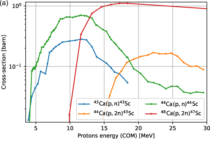

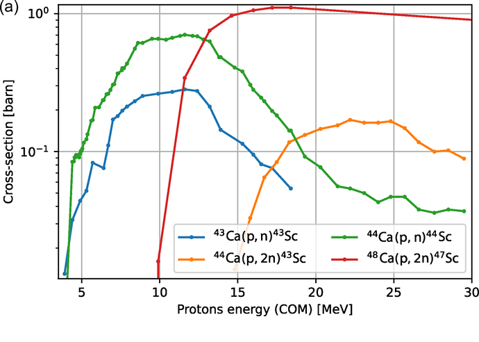

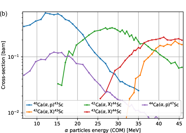

Dear @dprelipc,
Thank you for your suggestions. The Python script is very helpful for the analysis. It is observed that changing the incident energy of \alpha particles does not significantly affect the RESNUCLEi yield. This appears to be because we are effectively calculating a thick-target yield: as the \alpha particles lose energy rapidly within the target, the reaction occurs over a broad energy range, and the yield corresponds to an integral over \sigma(E) rather than a value at a single energy. As a result, any sharp features in the cross-section are averaged out, and the variation with initial energy becomes weak.
It therefore seems that increasing the yield would require optimizing the effective interaction region (i.e., matching the target thickness to the stopping range) and using higher beam currents. Please let me know if this interpretation is correct.
That being said, my intention is not necessarily to obtain a higher absolute yield, but to study how isotope production varies with beam energy and compare this trend with the known cross-section behavior (see attached).
Anupam
