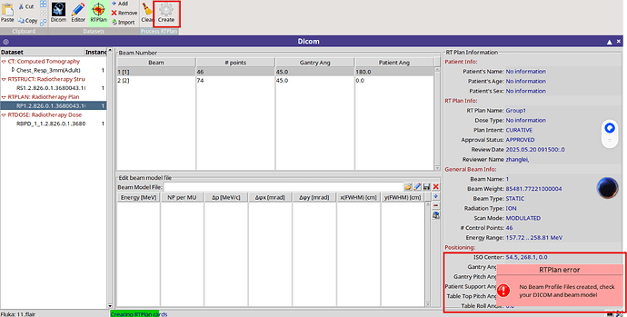

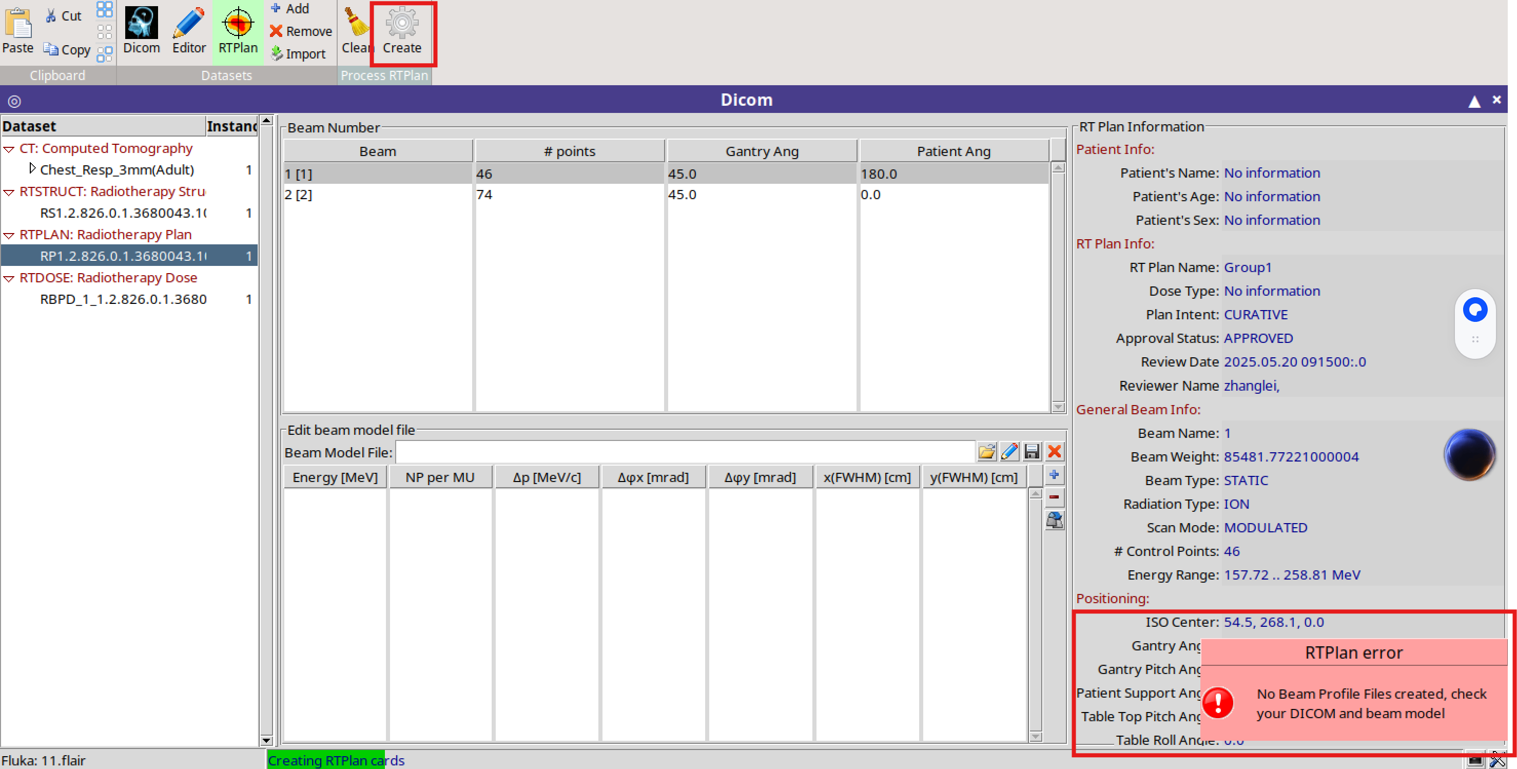

After I imported a heavy ion RTPLAN, where I tried to creat the input file for the source term, an error occurred. Is it because the used model is the LQ model and it dose not support conversion? If that’s the case, what other methods can I use to input the source items?
Thanking you in advance.
Dear @luochangli do you have any other error message in the output of flair?
If not we would need “privately” the DICOM files preferably anonymized so we can debug it
How can I send it to you?
