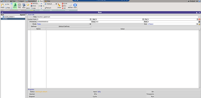

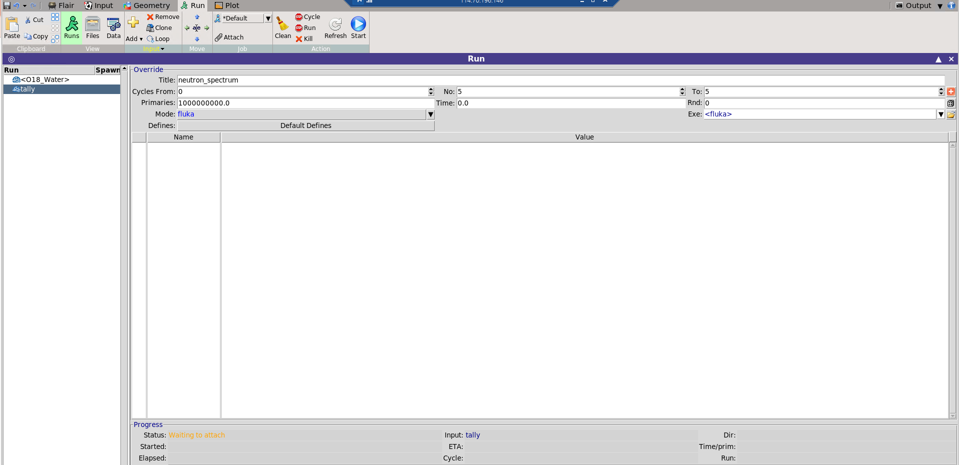

  1. So I thought it was because of attach in [RUN], but it just keeps saying ‘waiting to attach’ like below.
[RUN-attach] waitting to attach

Dear yjb,
[Data-Process] does post-processing of the data after the run is finished. To start the run, you have to hit the start button [RUN-Runs-Start]. The blue Start button is also visible on the top of your screenshot.
You can find more info on the use FLAIR here. Details on the RUN tab are on page 30ff.
Roman
