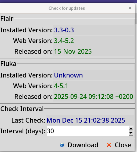

Also, the fact that you have installed an Unknown FLUKA version is somewhat problematic.
