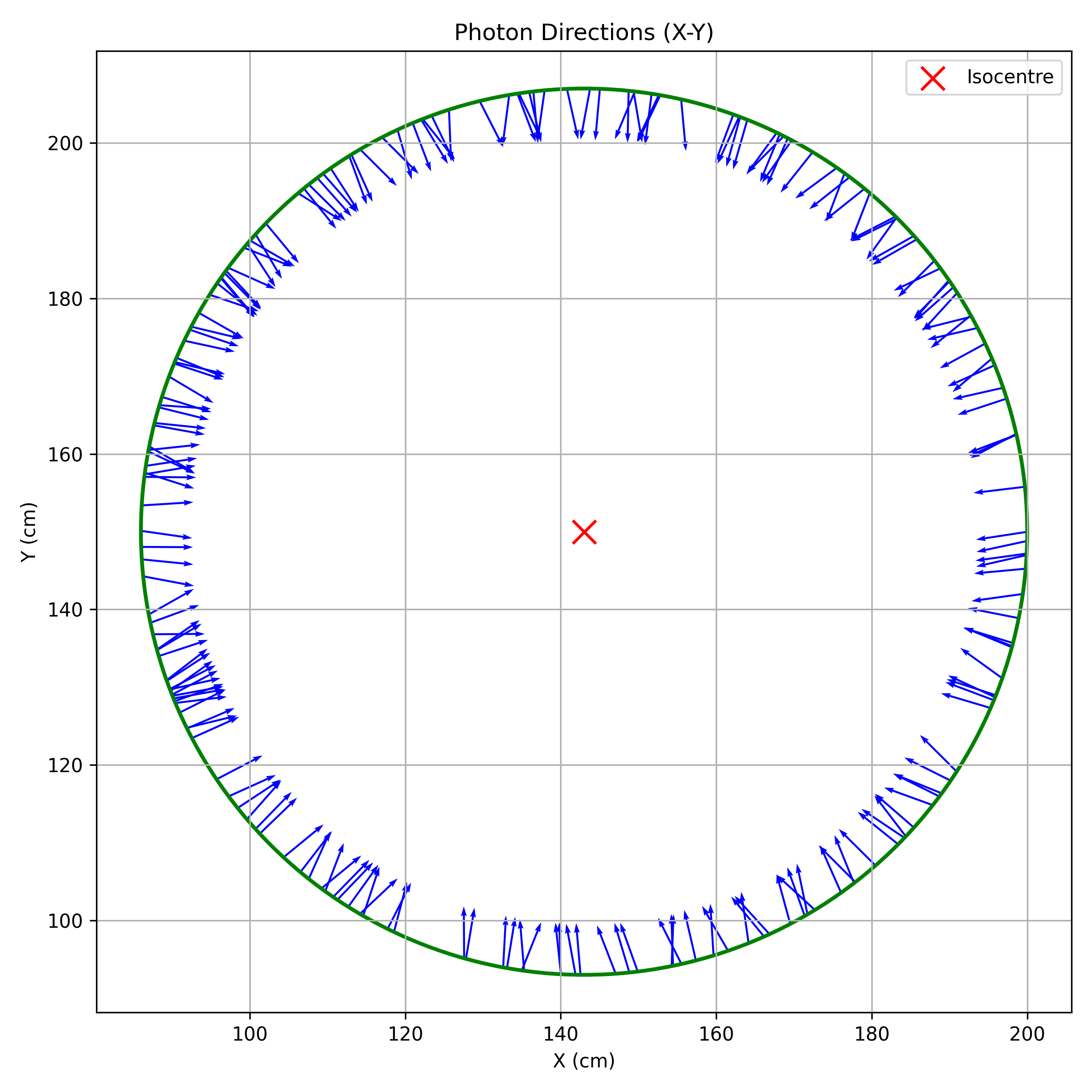

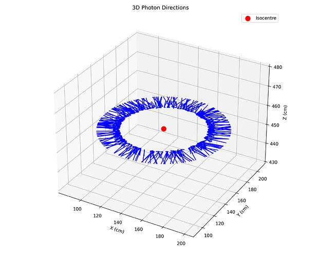

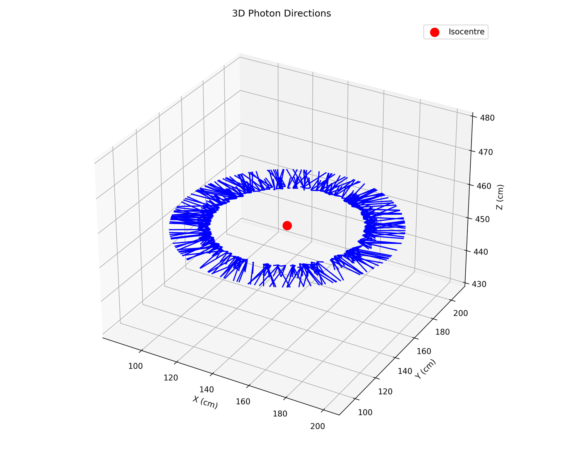

I am using a phase space file and a source routine to read the same. The source is a circular ring type where the direction vectors are towards its center (143 cm, 150 cm, 455 cm). Using a separate python code, I cross checked the position and direction vectors.

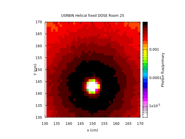

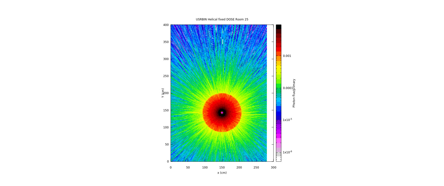

However, after analyzing the photon flux from the USRBIN output, I observed a small central region with dia approx 7 cm is devoid of photon when I took X-Y projection with Z ranging from 454 cm to 455 cm.

Dear Riya,
It seems to me that the photons with energies greater than 1 keV are not covering this center region, and photons with 1 keV energy don’t have the range to reach it.
