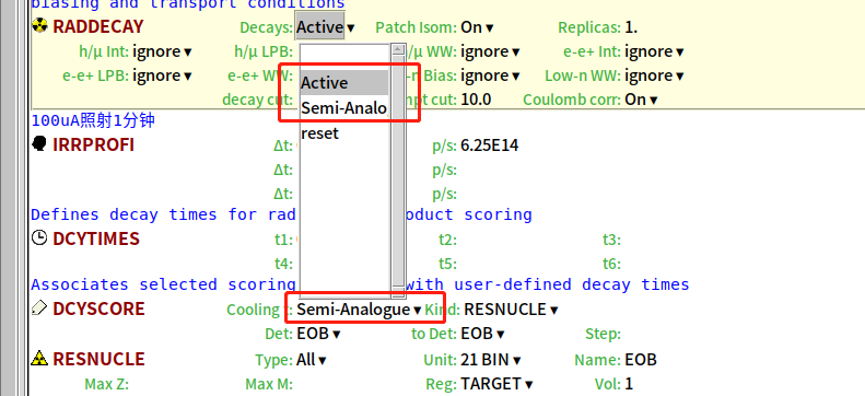

Regarding my previous question, I would like to know what happens if I select “active” mode in RADDECAY and choose “Semi-analogue mode” in DCYSCORE instead of “-1”? I would appreciate any clarification you can provide about the outcome in this case.

Sorry for my late reply. In the FLUKA manual such case is not documented, RADDECAY = active is always associated to a given DCYSCORE where the selected value is a defined cooling time. While RADDECAY = semi-analogue is always associated to a DCYSCORE = semi-analogue. My suggestion is to use these scoring cards as indicated by the manual.
Additionally, in the attached documents, you will find a flair file with a test with two scorers:
  • RADDECAY = semi-analogue associated with DCYSCORE = semi-analogue (correct use)
  • RADDECAY = active associated with DCYSCORE = semi-analogue
As you will see after running a simulation, the produced results are different, I would therefore suggest you not to use the second approach.

When RADDECAY = active, DCYSCORE = semi-analogue just gives the prompt contribution, identical to the scoring result without DCYSCORE at all.
