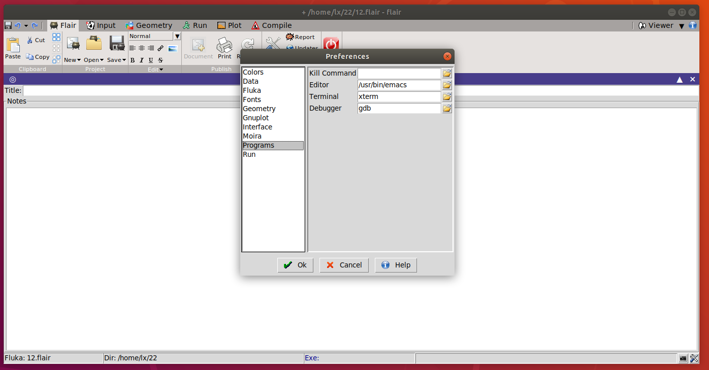

Dear David,
I have installed emacs on my system ,and my settings are as shown in the figure.
Li
Dear David,
I reinstalled emacs and the problem was fixed.
Thank you for your help.
