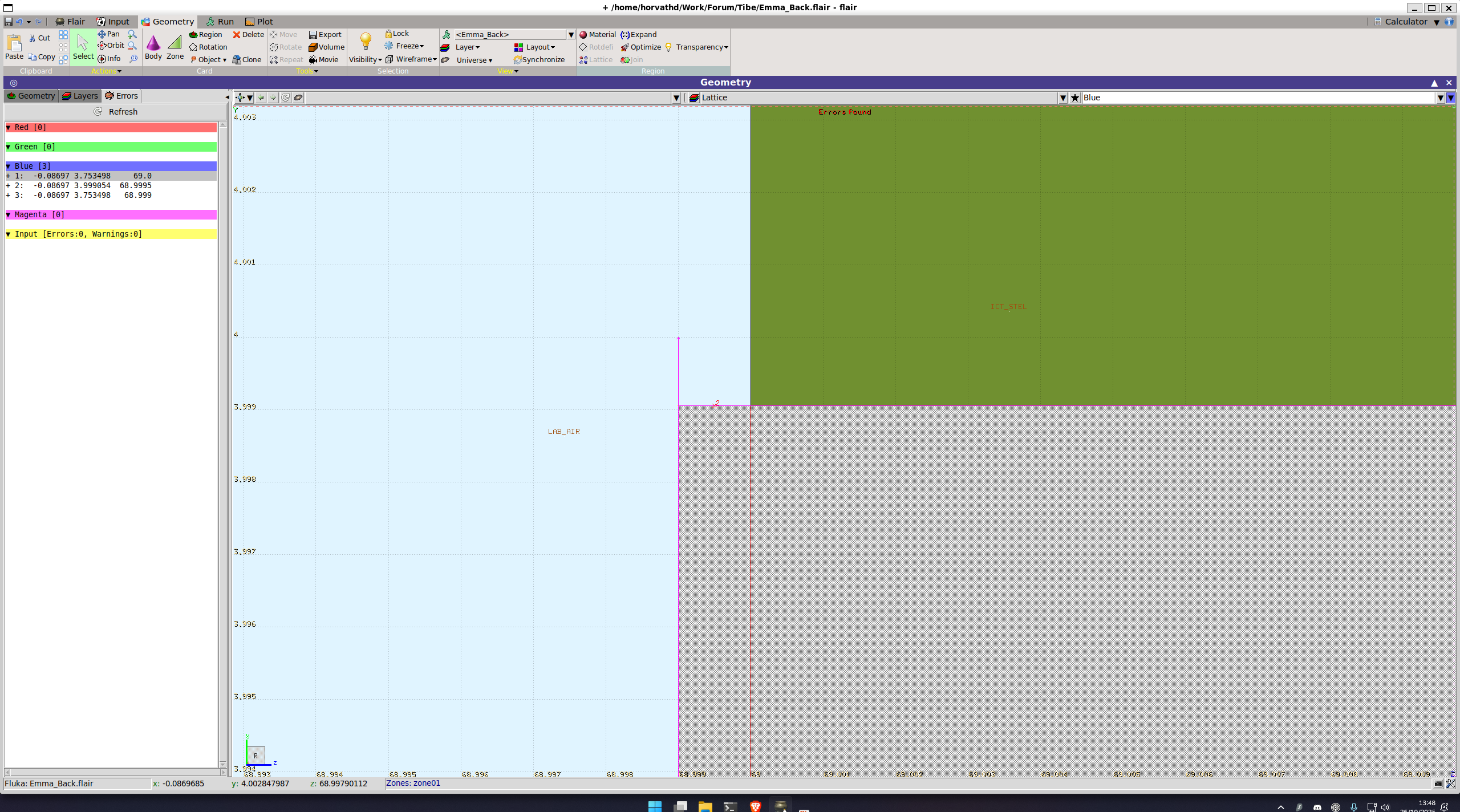

Dear TIbe,
So sorry for the delayed reply! I hope you managed to fix the issue in the meantime.
The problem could arise from the errors in your geometry, where regions overlap. See:
Hi David,
you are (as usual) right. I have completely redefiined the different regions and now everithins works fine! :slightly_smiling_face:
Thanks a lot.
