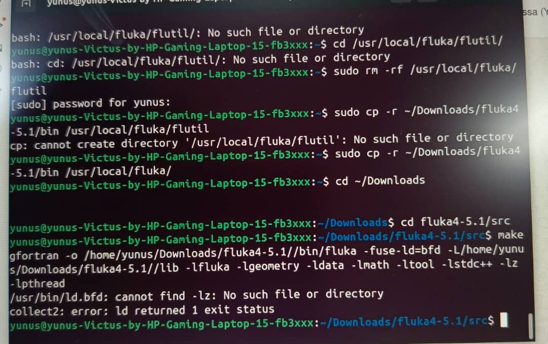

I want to install fluka in my PC. By following the ınstrtuctions in the website, everything was going well until I execute make. They show me that error
I looked at the related questions but I still can’t fix it. If someone can help me, I need it

Dear Inoussa,
You need to install the libz-dev package.
Yes, that was the issue. I solved it
thanks
