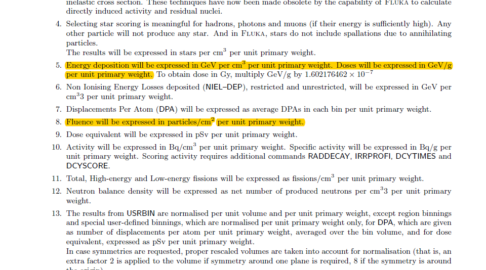

I used USRBIN to simulate the energy deposition and neutron fluence, I am confused about the units.
The unit of energy deposition is GeV/cm^3/unit primary weight and the unit of fluence is particles/cm^2/unit primary weight in the manual. Regarding the units, I don’t quite understand the " unit primary weight ". Could you please explain it to me?
