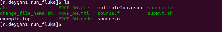

I have kept all the files in a single folder with name run_fluka (see the attached image). However, the output folder is at different location, with the directory name fluka_work. In this directory, although the input .inp is copied depending on the parallel jobs, the .ele and .node etc are not copied, hence it is not recognizing the mesh file, I guess.
Are you referring this?
When I use a single folder on the pc to run the file from flair interface, there is no issue.
In our cluster system, there is no graphical interface, so flair cannot be used. So I have to rely on the .inp file only.
