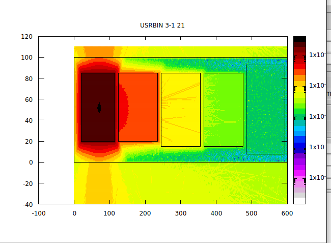

Here are the results of my initial calculation for automatic biasing, using 5e8 primary particles.
Subsequently, I adjusted the distribution of the source term to cover a larger area within the lead shield (although this did not seem to affect the results). These are the results from the run using manual regional biasing with 3e8 primary particles.
The points I am interested in include the maximum dose points outside the lead shield and outside the concrete room, which means that the entire modeling area must be considered.

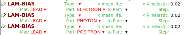

  3. Additionally, I am experimenting with the LAM-BIAS card. As you can see, does this setup provide beneficial results? (If possible, I will set it to air and concrete)

  2. In general, the more primaries, the more precise the results thanks to statistical convergence. For automatic biasing, the importance of each voxel is computed during the run; that is to say, if you don’t have enough primaries, then the voxels’ importance might be undercomputed. In your statistical checks, 3 tests are not passing. I suggest to run more primaries, as per Note 8. Moreover, your automatic biasing seems to work correctly.
  3. In your scenario, the LAM-BIAS cards will have minimal/negligible impact. If you are interested in the residual dose outside the shielding, then this will come mostly from the EMF component (as you suspected), but the LAM-BIAS cards will not help: they impact the nuclear interactions, which are not activated for photons, electrons and positrons in the absence of the PHOTONUC card, and which anyway have a very small cross section.
