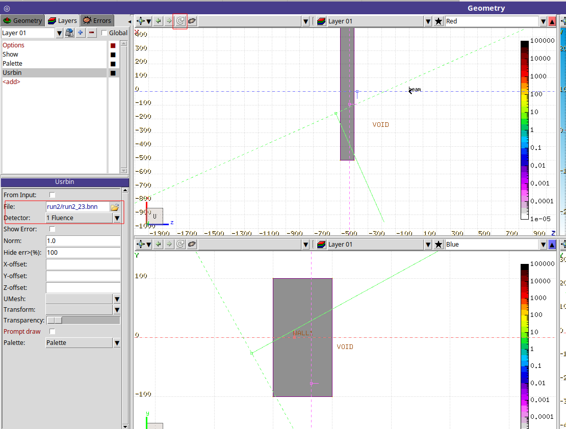

Thanks for your reply! Please, let me figure out what do you mean by “update” the Layer 01? I changed the Ursbin settings in the Layer 01 configuration. I set the input file to run2/run2_23.bnn (and clicked Apply button). Also I clicked “Refresh display” button on the viewport settings tab. Anything did not help!
Please, have a look at the screenshot below.
Sincerely, Ihor

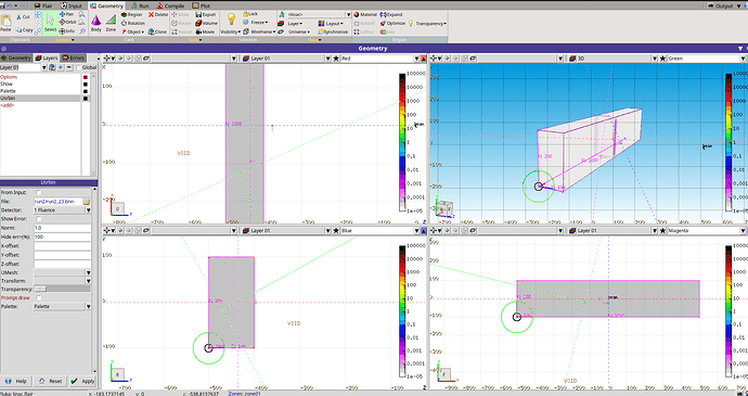

Dear David,
I even tried to re-install flair, but there is no result …
Still, the geometry and beam parameters look to be set properly, because I see some visual output (I added few additional walls and a slit in this version)

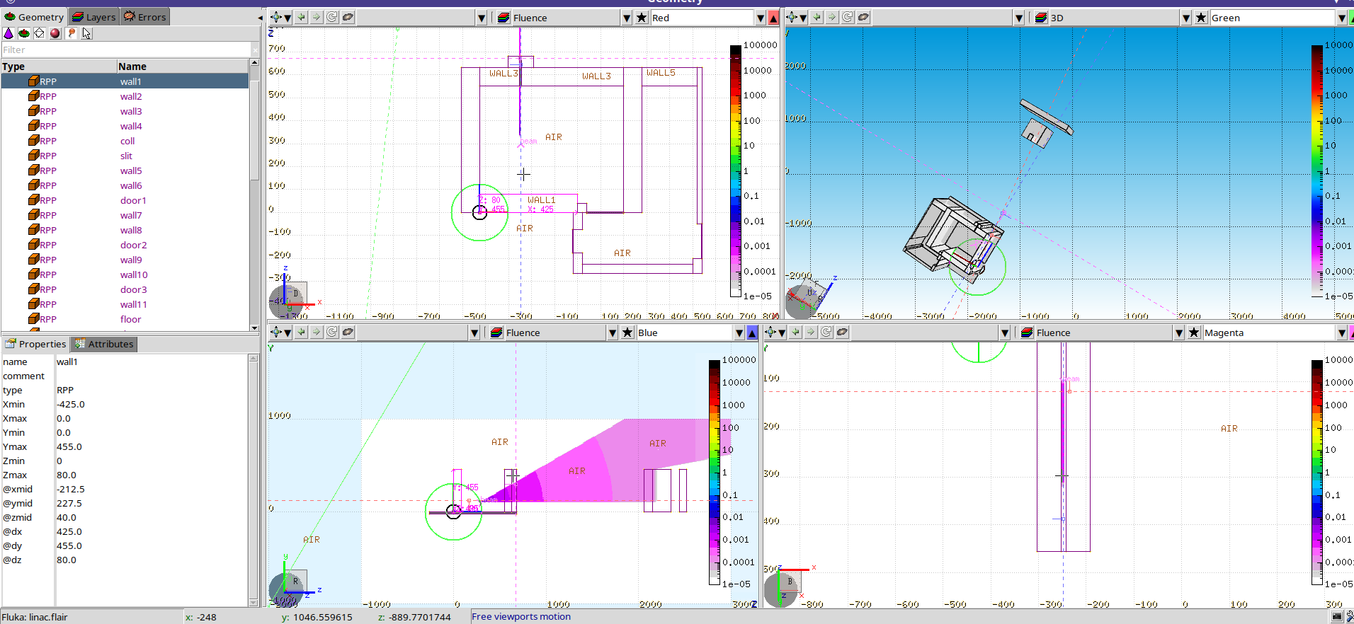

Dear @horvathd,
It helped! Thank you!
I deleted the ~/.config/flair directory and than reinstall flair via package manager.
Alfter, everything has worked as expected.
Thanks for the advice!
