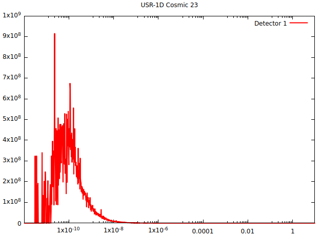

I tried to reproduce the results in this answer, but I couldn’t get the correct energy spectrum as expected, and the result I got is shown in the figure,
how to count dN/d(logE) in FLUKA
I simplified the computational model, using the air layer as the neutron source,the soil thickness is 6 m.The calculations were made using the cosmic neutron ray energy spectrum, but the resulting trend seems to be problematic.I can only calculate single-energy neutrons.
My calculations turn out to be such a trend:
[12]
The flux result trend of the relevant paper is:
[屏幕截图 2022-07-20 235144]
How do I implement the following energy spectrum calculations?At the moment it seem…

Dear Xuyang,
you need to have a log-log plot, with the plotted Value set to <X>*Y.
