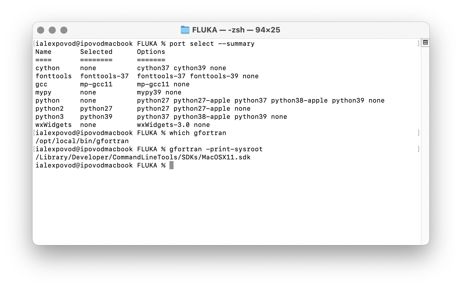

Dear @ialexpovod
to reproduce your problem, could you provide me these info:
  • What is the OSX version you’re using?
  • The output of the command port echo installed
  • The output of the command port select --summary
  • The output of the command which gfortran
  • The command gfortran -print-sysroot prints in the terminal a directory name. Does it exist?

Hello @ialexpovod
the M1 processor is rather new and the gcc installation is sometime still troublesome…
However, I was able to compile geoviewer and running Flair on a Mac with M1.
The Mac I used for test has
  1. macOS Monterey (the latest version of the OS, newer than yours)
  2. the same list of ports you have
However, I had to compile geoviewer with the debug option activated (as you also mentioned in a previous message).
Sometime, it might be useful to reinstall MacPorts since it can be corrupted.
Before doing that
  • Are you still using the changes implemented in PyInit_geoviewer?
  • Did you log out and log in to use MacPorts’ X11 as the default server?
