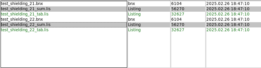

I have been working on a simulation to determine the linear attenuation coefficient (LAC) of some materials, based on the fluence data (particle/primary) provided by the files test_shielding_21_sum.lis and test_shielding_22_sum.lis [ln(21_sum.lis/22_sum.lis)/thicknes of sample)]. This approach has worked very well for obtaining LAC values, for point energy values.
