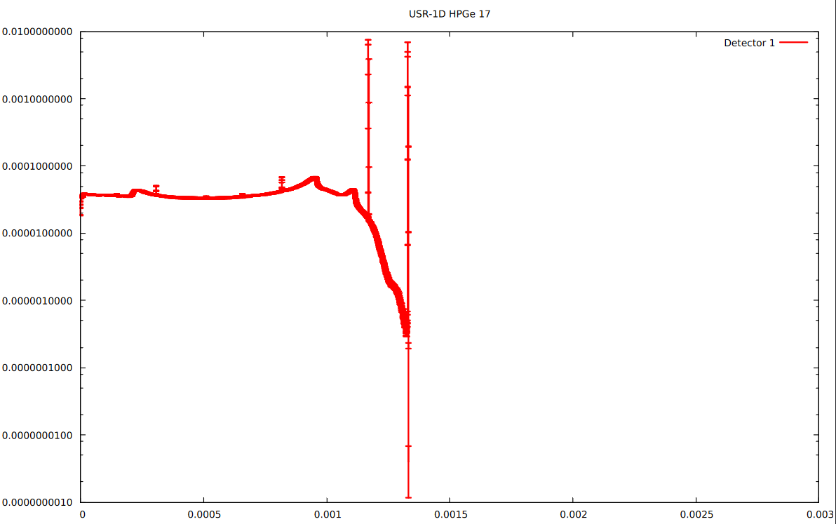

Then I tried compiling co-60 in source.f. DETECT results are obtained, as well as USRBDX results:
But it seems that there are certain differences with the posts I refer to:
Co-60.flair (1.7 KB)
source.f (9.1 KB)
I would like to ask the teacher to help check whether there is any problem with the program and source.f. I am a beginner, thanks to the teachers on the forum for helping me!
