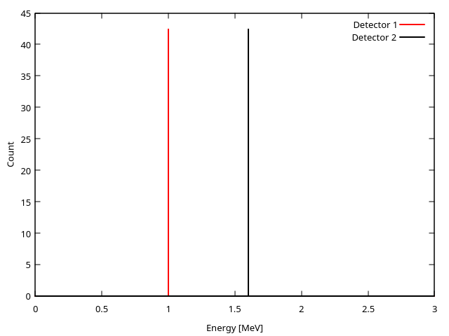

For EZ=-10 kV/cm, Elength=100cm, through this field electron increased Energy should be 1MeV, and detector 2 should be 2MeV. While it’s ~1.6MeV.

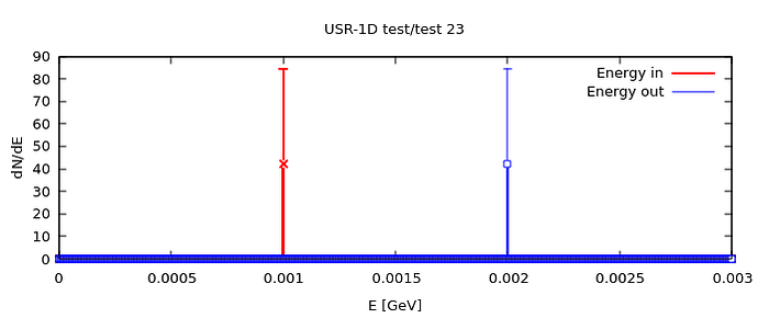

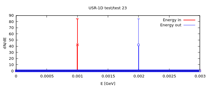

Worry not, we will fix this issue in the upcoming release. I attach here the plot you would obtain after the next update:
Nice catch! Have a nice day.
Daniele
