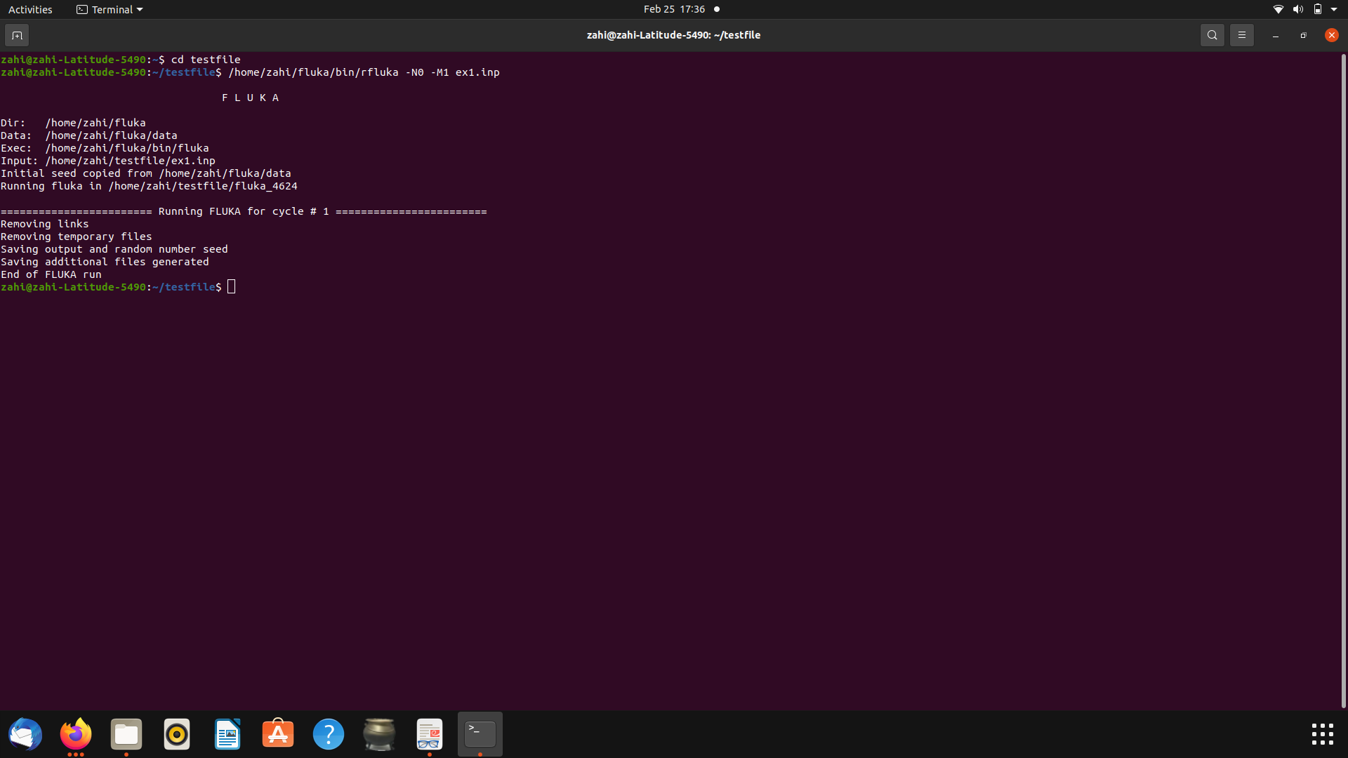

I have .tgz compressed file for Fluka [fluka-4-1.1.Linux-gfor9.tgz] and installed flair through the link. [Official flair site]
i have installed Fluka package few weeks before and successfully running a test file using the terminal command (screenshot attached) but while working on a n_TOF tutorial i can’t merge the files of scoring.

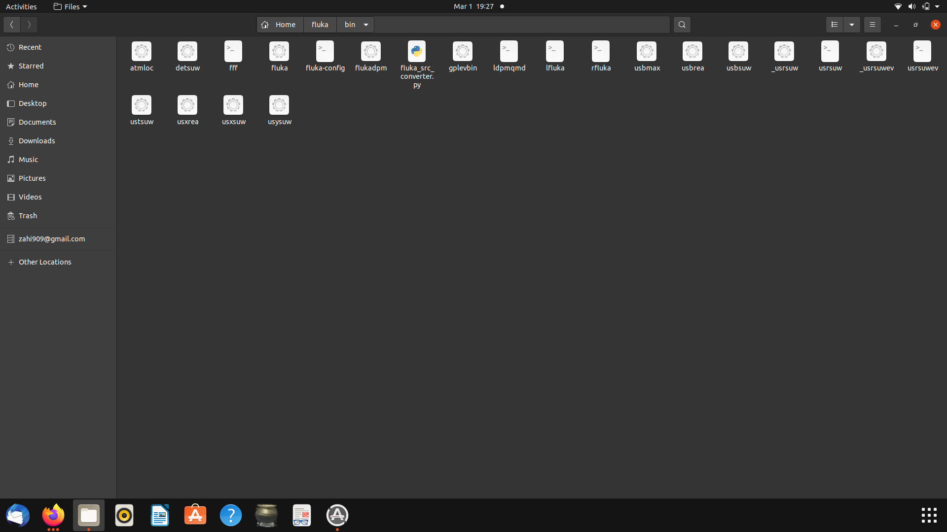

I have attached the shot that shows files included in the /bin directory of FLUKA folder.

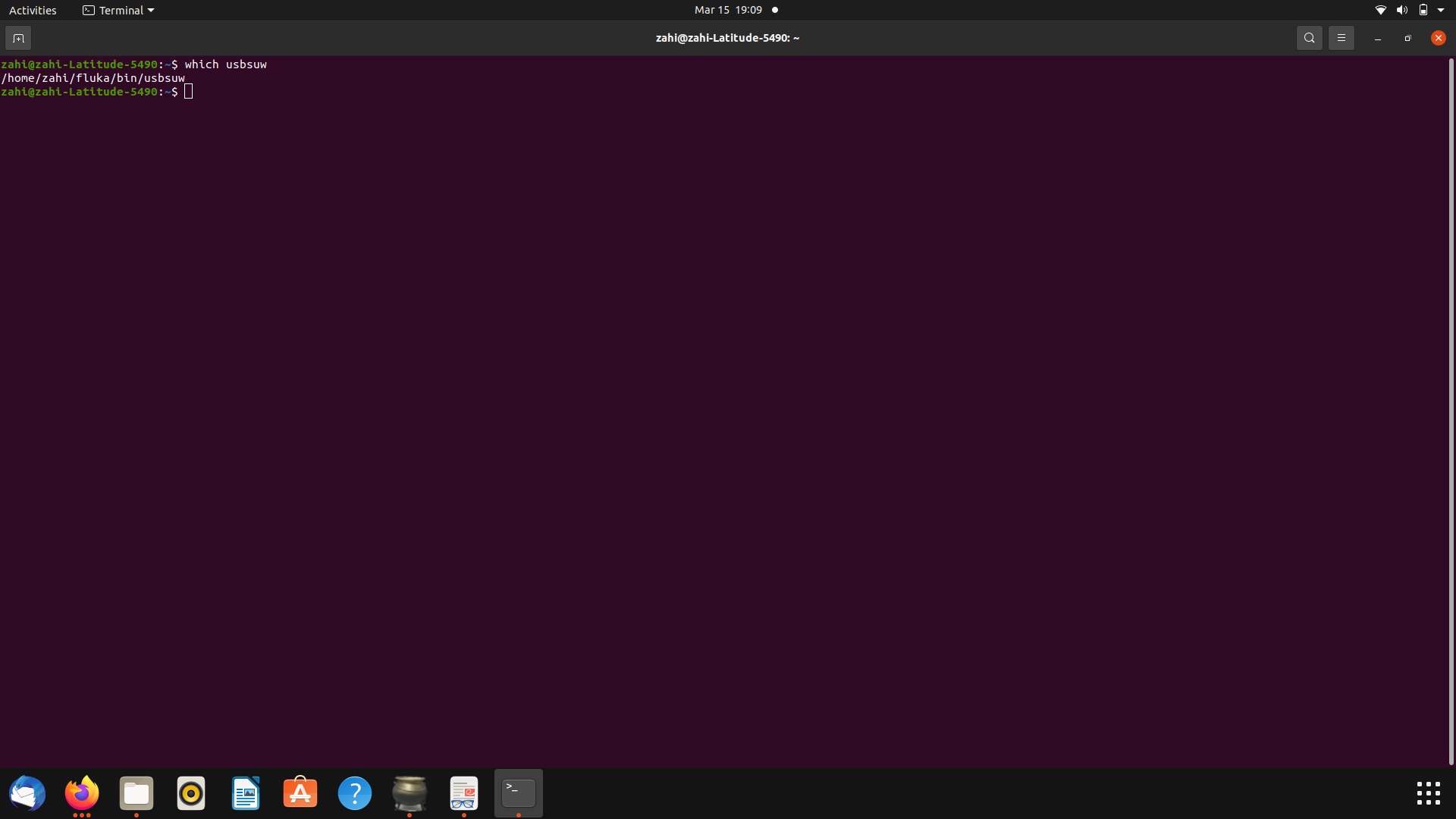

Dear @zahi,
it looks, you have the executable in the directory /home/fluka/bin but in the previous image suggests that Flair looks for the in /home/zahi/flukarun/bin.
In a new terminal please run the command:
which usbsuw
an let us know the result.
Sorry I am late.
Yes! you are right the problem is with the directory. Now i have set the correct path for the files in the Fluka Directory and it is successfully running. For reference i have attached the shot you requested.
