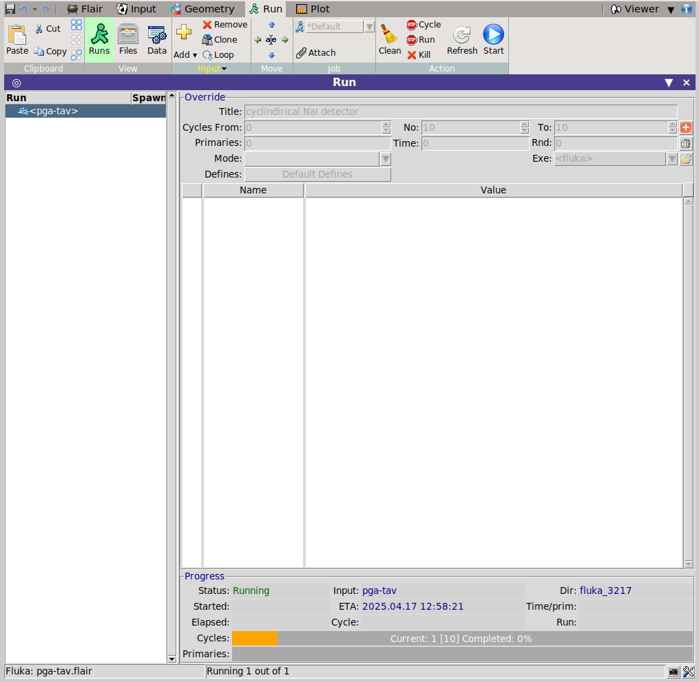

Running time estimation
I am trying to score photon fluence to calculate attenuation with NaI detector for a glass system. However I cannot monitor running time left for the calculation. It is not making any progress as in %. I increased the energy up to 1 MeV but didn’t work.
I’d be appreciated with the help
pga-tav.inp (3.0 KB)

I edit my input file to take into account absorption process in the detector. But runtime progress is still infinite. Previously, I didn’t have that problem when I was using different target material in the same geometry.
Regards
pga-tav2.inp (3.4 KB)
Hello
I tried this input and again it didn’t work.
pga-tav3.inp (3.5 KB)
