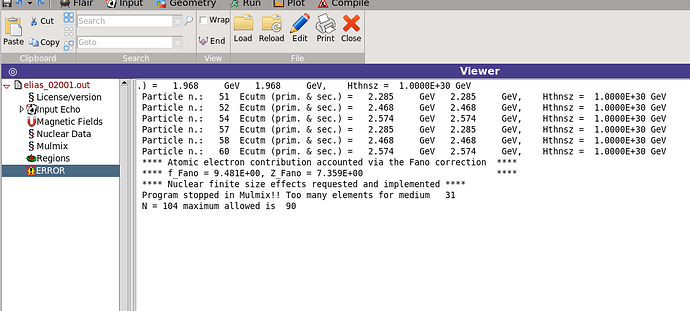

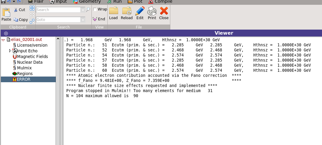

I’m testing my case with a low number of primaries while trying to study different aspects in a complex geometry as in attached files. After compiling the source routine and starting the run, the simulation stops with an error, but does not create any error files to check and investigate the issue.
I checked the log files and found something regarding materials that I could not understand.
I’m looking for your advice on this matter. Usually, Flair gives error messages that one can follow and solve, but in this case, it’s not even clear what the error is.

Currently, FLUKA only allows 90 different elements(isotopes), and some of your compounds (which are made of other compounds) exceed this limit.
